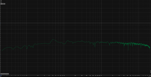

Now, the room I am using is only 3x3x2,5m roughly - a cube more or less. i have som treatment in my room and so far i worked with my samson resolv A8s + a HiFI sub. I've added the sub to accomodate to the room as the bass is canceled out quite a bit at my listening/mixing position so witht he sub, i get at least the feel and rumble. Additionally i am lisitening to my stuff in my hifi, car and couple of other devices. I have also a Behringer* Ultira curve PRo to DSP my Monitors (not the sub) so I am quite - linear.
As you can imagine this takes a lot of time going back and forth, and my assumption is that i can streamline this all a bit more to get to my desired results with better monitors. The problem with my sub is, it is directly coming from the output of my interface, there is no connection possible in the normal way where the monitors go into that sub. so the volume is only balanced at a certain setting - but i can live with that. i am only using the sub to check the very low end anyway and have it turned off usually while mixing.

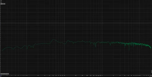

i think it's pretty flat when volume levels are set correctly, but when changing volume i cannot change the volume of the sub together with the monitors so things get out of proportion. this is the best i can get it to:
