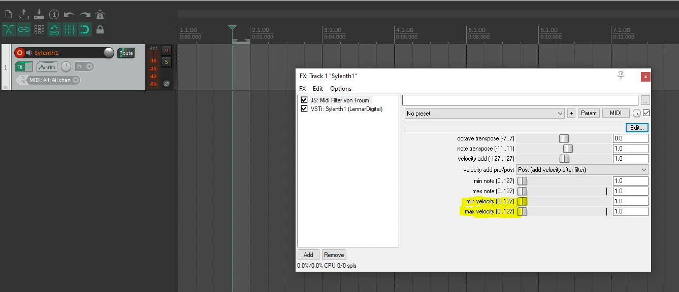

Jetzt hätte ich es gern, dass z.B. bei einer Velocity von 0-75 der erste Track angesteuert wird und bei höherer Velocity (75-127) der zweite.
Wie kann ich das in Reaper einrichten?

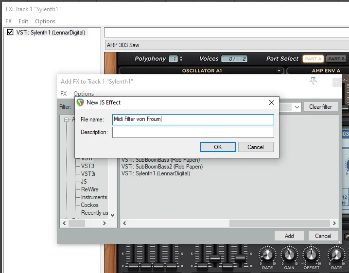

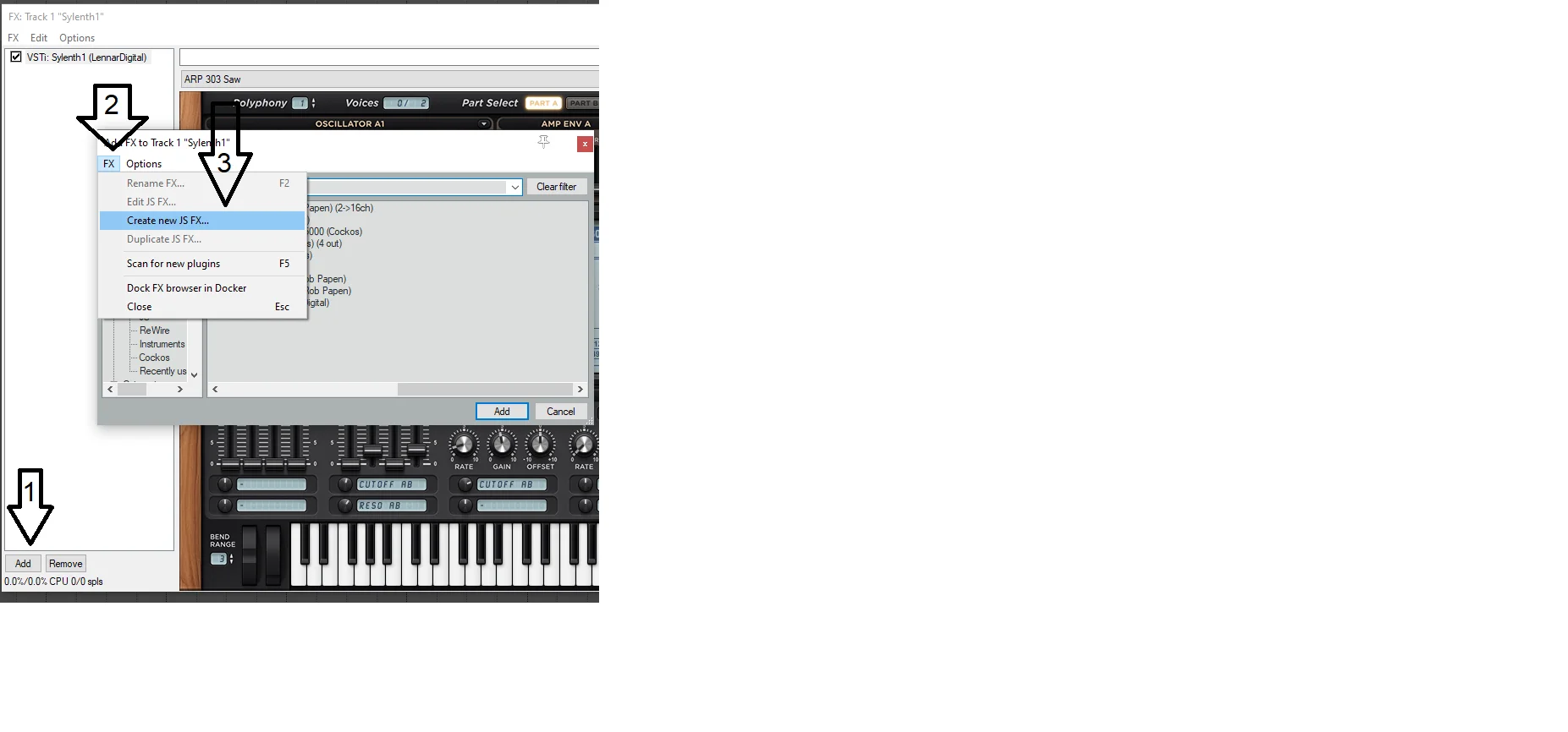

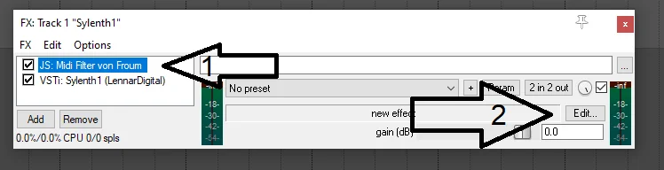

Von: https://forums.cockos.com/showpost.php?p=351636&postcount=15
Vorhandenen Code mit diesen überschreiben:

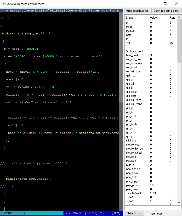

Code:
slider1:0<-7,7,1>octave transpose (-7..7)
slider2:0<-11,11,1>note transpose (-11..11)
slider3:0<-127,127,1>velocity add (-127..127)
slider4:1<0,1,1{Pro (add velocity before filter),Post (add velocity after filter)}>velocity add pro/post
slider5:0<0,127,1>min note (0..127)
slider6:127<0,127,1>max note (0..127)
slider7:0<0,127,1>min velocity (0..127)
slider8:127<0,127,1>max velocity (0..127)
//;slider9:0<0,1,1{off (let all pass),on (only ProgramChange)}>ProgramChange filter
// these lines tell Reaper the effect has no audio input/output,
// which enables processing optimizations.
// MIDI-only FX should always have these lines.
in_pin:none
out_pin:none
@init
slider1 < -7 || slider1 > 7 ? slider1 = 0;
slider2 < -11 || slider2 > 11 ? slider2 = 0;
//;slider9 < 0 || slider9 > 1 ? slider9 = 0;
@block
while
 midirecv(ts,msg1,msg23) ?
  m = msg1 & $x00F0;
  m == $x0090 || m == $x0080 ? // note on or note off
   note = (msg23 & $x00FF) + slider2 + (slider1*12);
   note |= 0;
   vel = (msg23 / $x100) | 0;
   slider4 == 0 ? ( vel += slider3; vel < 0 ? vel = 0 : vel > 127 ? vel = 127; );
   vel >= slider7 && vel <= slider8 ?
    slider4 == 1 ? ( vel += slider3; vel < 0 ? vel = 0 : vel > 127 ? vel = 127; );
    vel |= 0;
    note >= slider5 && note <= slider6 ? midisend(ts,msg1,note+vel*$x100);
//;   slider9 == 0 || m == $x00C0 ?
   midisend(ts,msg1,msg23);

Vielen Dank - genau das, was ich gesucht habe!
