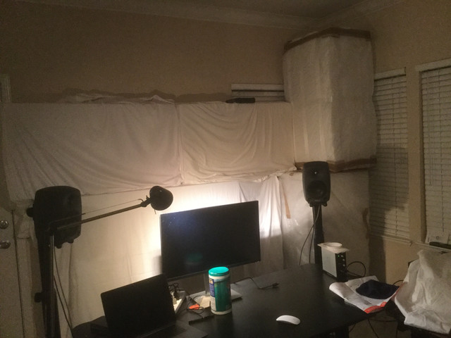

I’m from Mexico and a couple of months ago I bought plenty boxes of IsoBond. The reason I bought it is because I saw many pictures where people did not cover the material. For me it has been a nightmare as it is very difficult to breath with when the Caruso boards uncovered. Did you cleaned or applied something to your iso bond sheets here installing them in your room ?
See the pictures
Thanks
a>
How do you mean "For me it has been a nightmare as it is very difficult to breath with when the Caruso boards uncovered." ?
do they 'smell' ?
Hi,
No, panels are odorless. I feel as if there wasn’t enough air in the room. In addition to that, my eyes get a mildly irritated that I need to wash them. It is very frustrating as I purchased 8 packages of WGL 035 and 4 of WGL 040, and I can’t enjoy them. Did you do something before installing them in your room. ?
