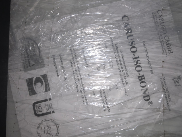

No, panels are odorless. I feel as if there wasn’t enough air in the room. In addition to that, my eyes get a mildly irritated that I need to wash them. It is very frustrating as I purchased 8 packages of WGL 035 and 4 of WGL 040, and I can’t enjoy them. Did you do something before installing them in your room. ?
Do you mean the fealling of silence ? I think it is when the damping / absorbtion is to much.
I also have that here, but meanwhile I am used to it.
Probably i wil cover the walls some day with something to improve this but I don't have the resources yet.
my eyes are fine with the isobond. You are sure that you have isobond ?
I haven't threaten the panels in anyt special way, I just cut and mounted them.
  • #42
Let's say I stay in the living room with 1 panel uncovered for 1 hour, then I start feeling there is no air. Once this sensation of no air kicks in, it takes hours or 1 complete day to disappear.
Sure it is isobond, I've got it shipped from Germany, it takes from 20 to 30 days, but they arrive.
I'm thinking they probably mold spores or something. I'm thinking to vacuum clean one outside the apartment and then apply anti mold spray. If no results, then Im going to cover them.
Thanks for the information. I was thinking you applied something before placing them in your room which by the way looks very nice. I probably contact Caruso directly to see if I have further options.
thanks,
Francisco.
thanks,
Francisco.
I apologize that I cant help you here, please write to caruso and askthem regarding your assumptions. I hope that helps somehow. After writing them , you atleast know if they have treaten the panels with something chemical. I doubt tho. :/
