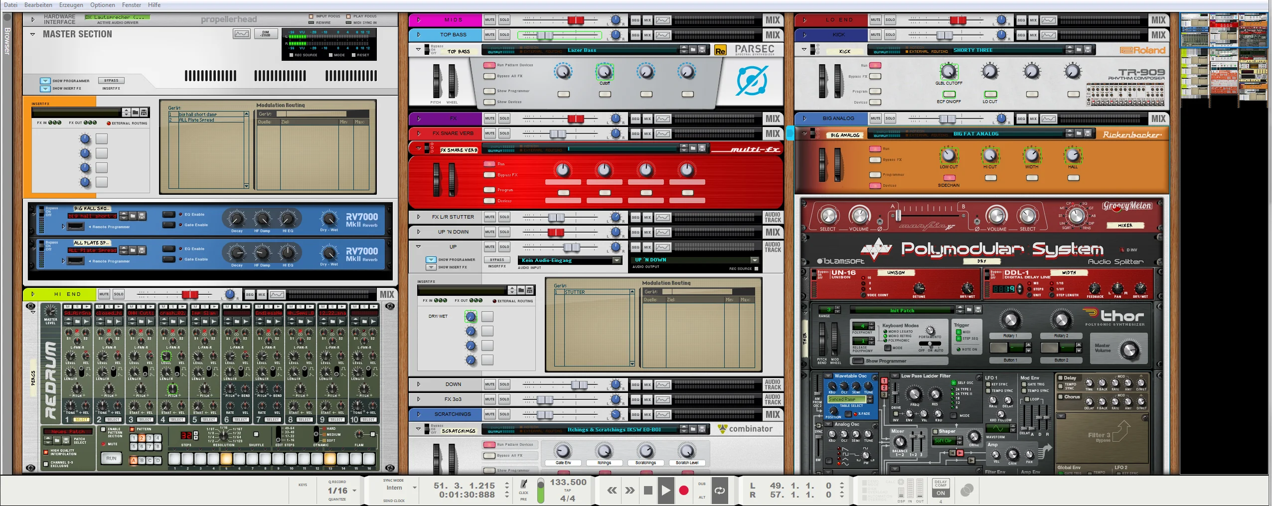

The first are the View of Rack Row, the Vertical Row WASTED almost the HALF of SCREEN VIEW.
Why is not possible to Zoom* (vector graphic) the Vertical Row to full exploitation of the visible area?
Working with Reason on e.g. 15" Screen Size Laptop are almost impossible (Eyestrain).
There is a lot of beautiful Instrument Racks, but the comprehensive GUI’s with all the controls are just a “target practice” to handle at this small visible area.
To avoid misunderstandings of my suggestion I provide you 2 “tinkered” Images to show you what I mean.

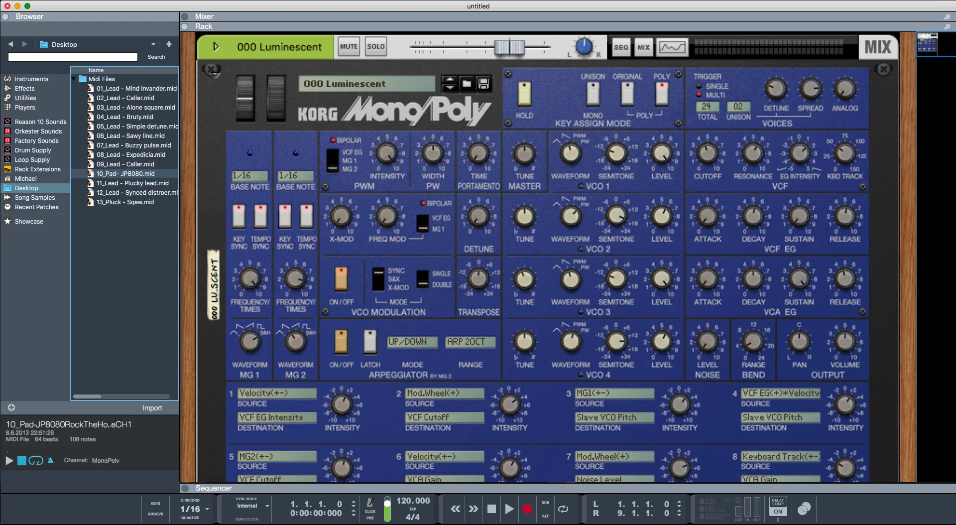

In this Image called “Reason Happy” you can also see at the lower left corner my second desire/suggestion.

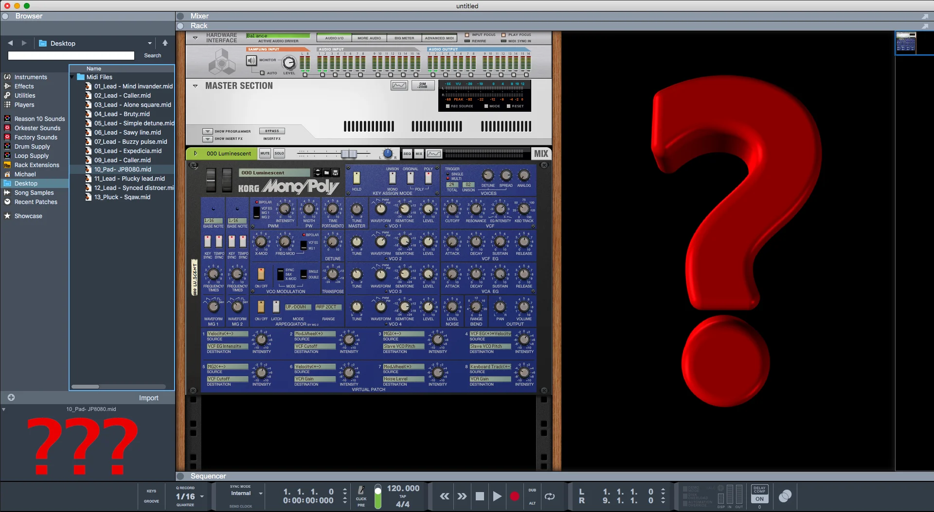

In my workflow I’m used to use sundry MIDI Files such some Bass-Lines, or Drum-Patterns.
In Cubase or Studio One (see Annex) I was used to preview (with selected Device) & toggle any MIDI-Files (on-the-fly in the Browser) while playing the project.
Unfortunately this Elementary Sequencer Function isn't possible in such advanced DAW like Reason (but I could of course be mistaken)?
If I like to Preview some MIDI-Files, I have to move it into the Instrument Track for play it.
When this MIDI-File does not match the result, I have to delete it and repeat the procedure over and over again till I’ll find the right one.
This workflow are big Time Wasting if you will try to preview dozens of MIDI Files, it’s not practicable at all.
In the Image “Reason Sad” I was pointed with “question mark” the mentioned locations/functions.
The Image “Reason Happy” are just a “basic notion” only to express practically my suggestion/implementation.

Auf die Gefahr hin, dass ich dein Problem warscheinlich nicht richtig vertanden habe -
Da wo das große Fragezeichen ist, kannst du weitere Geräte per ''Drag n Drop'' platzieren.
Leider rasten diese nur untereinander ein, vertikales Einrasten würde der Übersichtlichkeit zu gute kommen. :schulterzuck:
Wenn du schnell ein bestimmtes Gerät finden möchtest,
dann kannst du im Sequencer einfach aufs Gerät klicken
und es blinkt im Mixer sowie im Rack auf.
Im Mixer befinden sich zwei kleine Knöpfe direkt über den Kanal-Bezeichnungen
welche dir das gesuchte Gerät ebenfalls anzeigen werden - im Rack sowie im Sequencer.
- das müsste dein Workflow ein wenig verbessern :)
Eine Vergrößern-Funktion wäre vllt. nicht verkehrt, stimmt :)
Wenns um die Feinjustierung geht - In den recht überschaubaren Einstellungen,
findest du die Empfindlichkeits-Stufen für die Regler.
Zu deinem zweiten Punkt - nur bei Audio Samples
im Browser findet man in dem Bereich wo ''Importieren'' steht einen kleinen
Play Button / Autoplay Button und einen Lautstärkeregler für die Samples.
Ein Loop-Funktion könnte natürlich hilfreich sein.
Zu den *.mid Dateien kann ich nichts sagen.

Um es wenigstens entgegenzuwirken sollte es doch wenigstens möglich sein, so ein Rack-Reihe bzw. Instrument auf die Volle Breite von Rack-Window zu skalieren.
Reason ist nicht skalierbar - bis jetzt. Eine "Spalte" bzw. ein Device kannst du leider nicht auf die volle Größe deines Bildschirms "zoomen" (bei einigen VST´s ist das anders soweit mir bekannt - allerdings kann ich das nicht 100%ig bestätigen - ich arbeite nicht mit VST´s).
Du meinst horizontal, oder ? Wie dem auch sein, ist so nicht richtig. Du kannst in Reason so viele Spalten nebeneinander generieren wie du willst. Du musst lediglich jede Spalte auch mit irgend einem Device belegen. Was das bringt, ob vertikal oder horizontal, ist wohl Geschmackssache.
Für meinen Teil habe ich 3 Spalten generiert, nach Lo/ Mid & Hi getrennt. Mein Screen kann das gut darstellen.

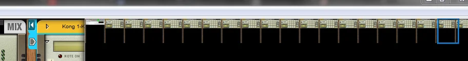

ich meinte damit, dass man die in der höhe nicht rasten kann
edit:so dass da platz da zwischen bleibt:)
edit: auf der Y Achse bei jedem beliebigen punkt festnageln wäre praktisch ohne das etwas an dem höchstmöglichen punkt andockt
Was genau erhoffst du dir davon?
Anfrage an das Propellerhead Support war reine Zeitverschwendung und für den *****
Ja, sowas ist natürlich unschön. Aber in der Sache haben die PHeads recht - wobei sie da doch etwas kulanter hätten vorgehen und dir helfen können.

@alex-reed , @BEATSTER
Je nachdem wie man vorgeht. In erster Linie eine bessere Übersicht.
Ich hab z.B. jedes einzelne Signal des ReDrum in ein Mix-Kanal geschickt,
somit 10 Kanäle die da drunter angebracht sind.
Danach hätte ich gerne ein wenig Platz frei, wie gesagt für die Übersicht.
Manchmal hat man den ganzen Spaß auch noch ein zweites mal (für den doppelten Percussion Spaß) und das dann am liebsten direkt daneben und nicht versetzt da in der ersten spalte noch die Master Section für den Versatz sorgt.
scheint ja nur mein Problem zu sein :confused::D
