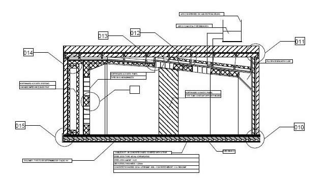

Welcome Thomas!
As they only interact with self-noises, no.
Good point. So in theorie they can even be reflective plates cause they are only for "self-localisation" on the listening position? Is that what you mean with "self-noise"?
Self noises are the noises you produce while in the room. So talking, walking, moving your mug or chair around, etc. These are indeed the ones interacting with the cues. The speakers aren't meant to interact with cues and we minimize that as much as possible so we manage a NE response from speaker to room - basically removing the room from the equation (except floor).
Reflective plates won't work. They would interact way too much with the speakers and thus create nasty early reflections, greatly augment the level of interaction of the speaker with the cue and give uselessly high cue feedback, and a cue not spread in time enough.
The fact that the cue is diffused is a factor that contributes a lot to putting the brain "at rest". A very quick generalization here: a heavily diffused cue doesn't draw the attention of the auditory system too much to the actual Cue. It does not trigger a conscious reaction. Remember we're tricking the primal brain here, it needs to be subtle, not obvious. For example, putting a QRD type diffusor in the ceiling would not work either. Still too "obvious" a cue. The brain would try and correlate it (in short: try and get meaning out of it - ref to environmental cues vs semantic cues).
Looking at the way the ceiling cues are positionned (recessed in heavy treatment, at an angle) and the way the diffusor is designed (it's a deep diffusor, with a specific pattern, a very lossy design = lots of absorption from edge diffration) should point at the fact that the area that is actually visible to the speaker is very, very limited. And very much spread in time (= less reflected energy per time unit).
See it that way. The ceiling diffusor is angled usually anywhere from 7° (small rooms) to 20° (large rooms) and is around 90cm long. Because of the angle of incidence, the amount of energy reaching it and thus being reflected is very small, and already spread over 2.5ms before any diffusion happens from the actual diffusor itself (just from the distance factor).
I attached a small drawing to make it easier to conceptualize.
It is by all means, invisible to the speakers, and thus, invisible within the speaker to engineer and speaker to room relation.
