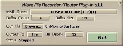

http://www.voxengo.com/product/recorder/
"Recorder is an [g=123]utility[/g] audio plug-in which allows you to record the output of the [g=190]channel[/g] or [g=183]bus[/g] into the stereo WAV file of specified [g=395]bit[/g] depth. Routing to MME (multimedia extensions) soundcard is also supported."
Tolles [g=8]Plugin[/g]! Wenn es doch nur gehn würde.
