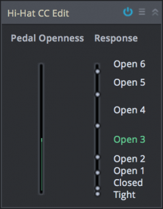

Hier kannst du mal sehen, was in SD3 geht:
3.5.13 HI-HAT CC EDIT
The Hi-Hat CC Edit Property Box gives you control over how Superior Drummer 3’s Hi-hat reacts to the incoming Continuous Controller messages (i.e. the CC messages sent from a physical E-Drum Hi-hat pedal or MIDI controller). Dragging the nodes up or down determines the point at witch the corresponding articulation will start to sound based on the incoming CC04 level (0-127). 127 being the tightest closed Hi-Hat sound and 0 being the most open. The level meter to the left of the Property Box will display any incoming CC data. The corresponding Hi-Hat articulation to the CC value will be displayed in green to the right.
It should be noted that Toontrack MIDI packs do not currently use CC info for Hi-Hat openness (dedicated notes are used). Therefore, altering this Property Box while using Toontrack produced MIDI from the Grooves tab will do nothing. The Hi-Hat CC Edit Property box is therefore intended to be used with user recorded MIDI, or for making further preset specific alterations to the Hi-Hat response when using E-Drums. As always the MIDI In / E-drum Settings page should be used first to dial in a general response to your specific Hi-Hat and module, but you may find that further tweaks are needed when changing Libraries/Presets. In this case, rather than change the general E-Drum Preset you have created in the Settings page, you can create preset specific tweaks in the Hi-Hat CC Edit property box.
Reaktionen: nemesis0381
Das sieht schon mal sehr gut aus.
