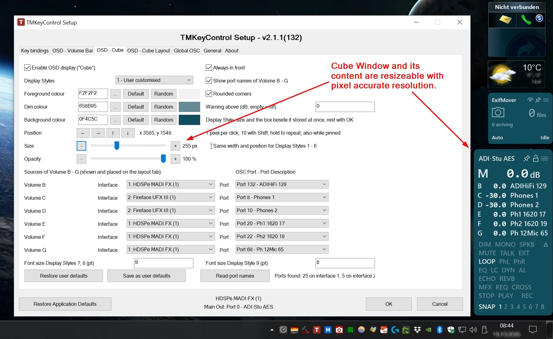

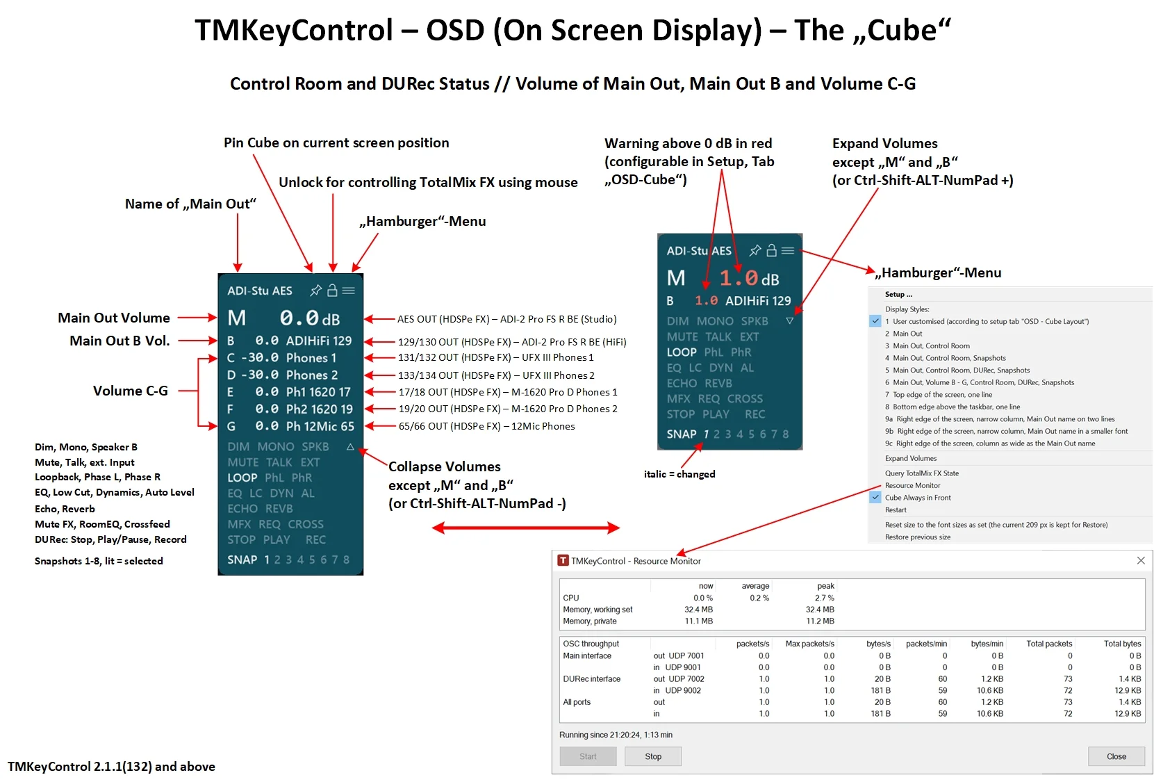

OSD cube
* OSD "cube": control room permanently on screen, like a desktop gadget
* Cube shows Main Out level in dB with port name from TotalMix, DIM, Mono,
Speaker B, Mute, Talkback, External In, Loopback, Phase L/R, EQ, Low Cut,
Dynamics, Auto Level, Echo, Reverb, Mute FX, RoomEQ, Crossfeed with level
* Cube shows DURec transport (REC red, PLAY green, PAUSE yellow) and
snapshots 1-8, a snapshot changed after loading in italics
* Volume B to D: up to three more output levels, e.g. phones; source by
interface and OSC port, port names read from TotalMix
* Warning colour above a set level, muted outputs dimmed
Cube operation

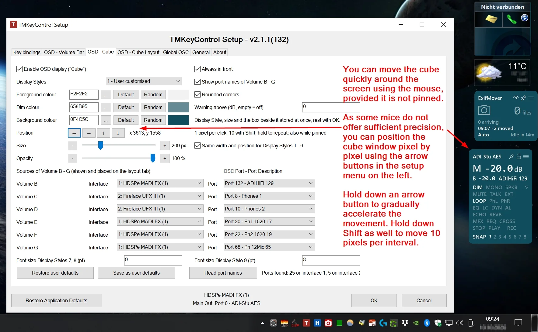

* Cube window movable by mouse if not pinned, no window border
* Pin: fixes the cube; levels M, B-D then changeable by mouse drag,
with Shift in fine steps
* Lock: when open, a click on a word switches it, loads a snapshot or
controls DURec
* Menu: setup, Display Styles, size reset and restore
* Cube Always in Front, also switched directly in the tray menu

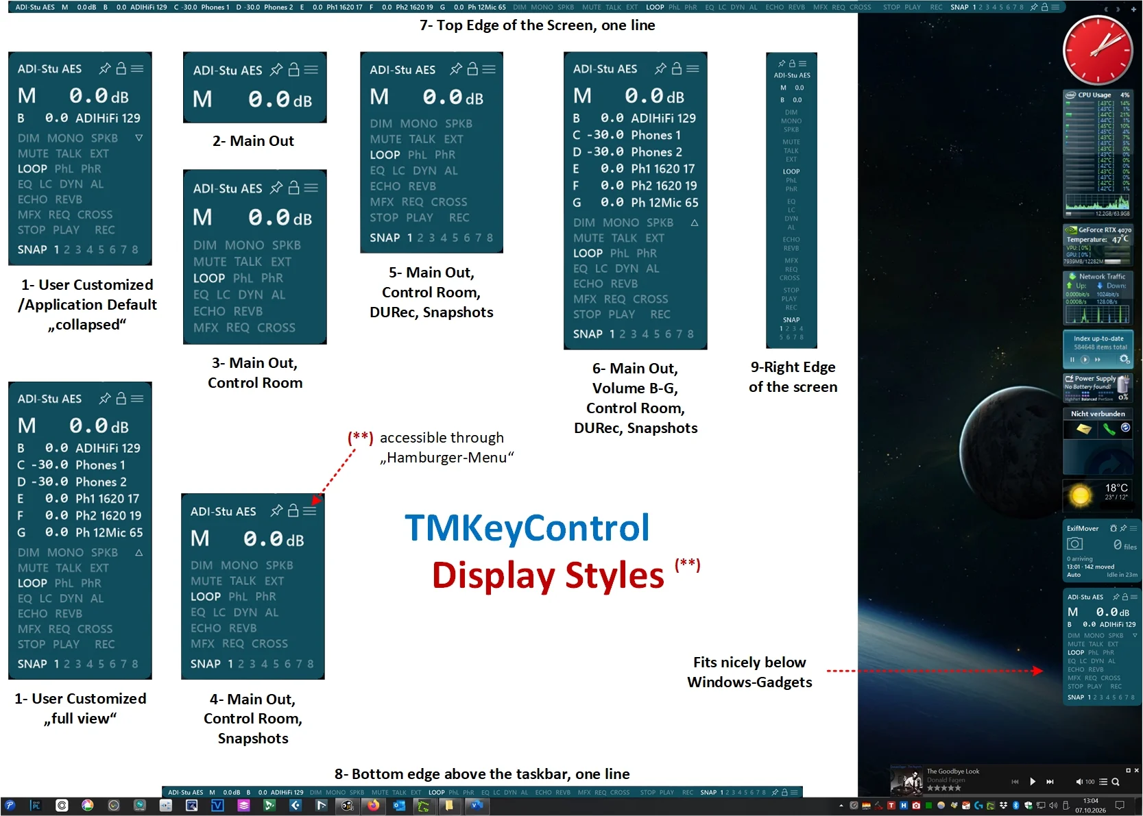

Cube look
* Nine Display Styles: user customised, five predefined, a line at the top
or bottom edge, a narrow column at the right edge
* Layout per element: shown or not, order, alignment, border, font size
* Size 30-200 % per Display Style: slider or -/+ in 1% steps, live preview,
previous size restorable, top-right corner stays in place
* Position: arrow buttons for fine work (Shift = 10 px), held buttons speed
up; stored per Display Style, always inside the working area

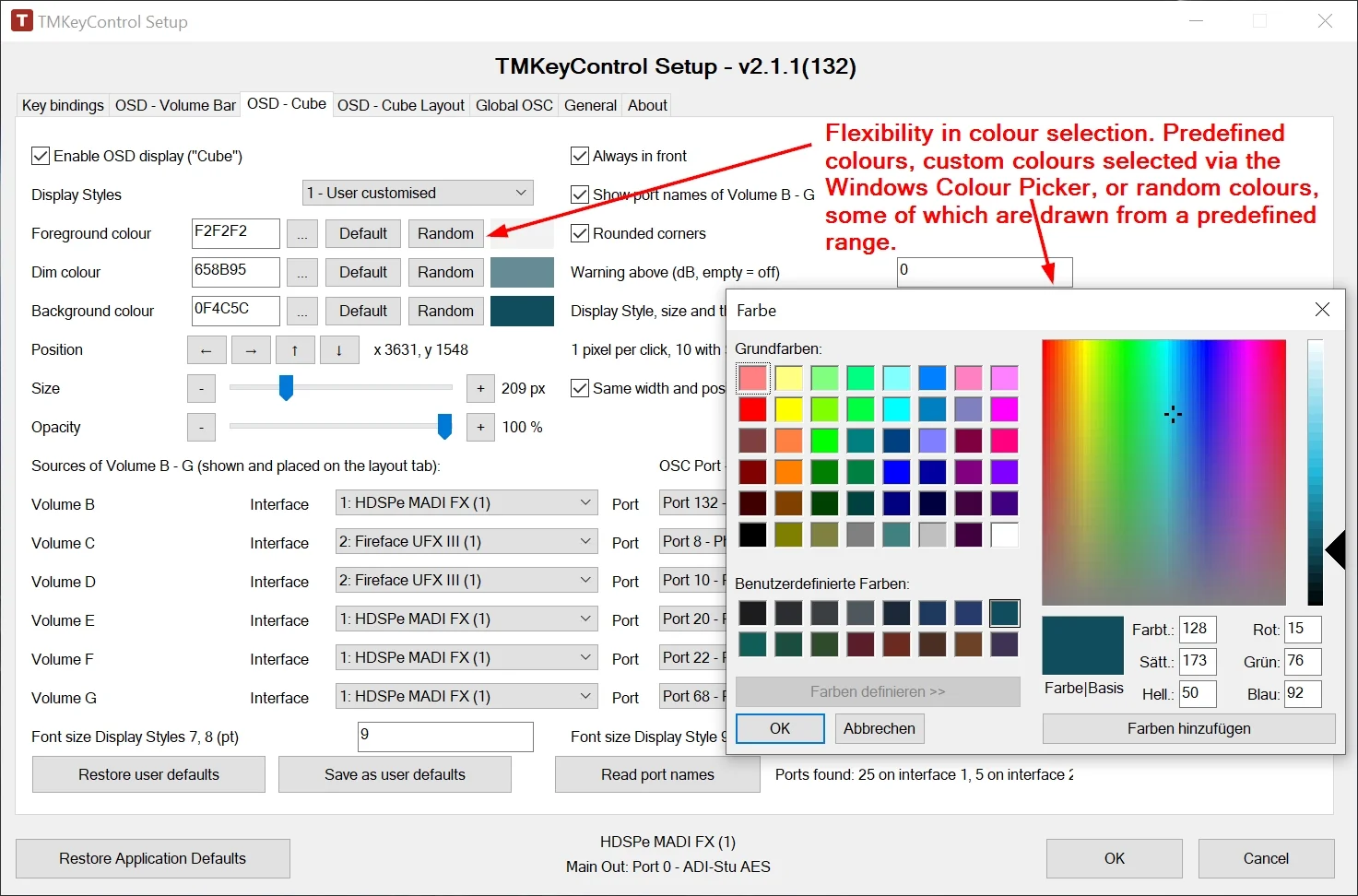

* Colours of text, dimmed text, background: colour dialogue with matching
custom colours, default, or "guided" random; opacity 20-100 %, rounded
corners

Ein paar Bilder ...
Installation:

* Kontrolle über insgesamt 7 Ausgangspegel (Main Out, Volume B, C-G).
* Volumes eines später eingeschalteten zweiten Interfaces werden automatisch erkannt.
* Die Volumes C-G sind per Menü, Hotkey oder Dreieck am Cube ein- und ausklappbar.
* Die Skalierung des Cubes (Fenster und Inhalte) ist nun pixelgenau.
* Das Verschieben des Cubes per Pfeiltasten (Setup) erfolgt pixelgenau.
Beim Halten wird nach einer Weile beschleunigt.
Das zusätzliche Halten der Shift-Taste bewirkt ein schnelleres Verschieben um 10px.
* Time saver: Eine Option im Setup bewirkt, dass Positions- und Größenänderungen
des Cubes (Skalierung) für alle 6 Display Styles (1-6) gelten.
* Display Styles 7-8, mittige Darstellung, Volume C-G einklappbar.
* Display Style 9 in drei Varianten wegen langer Namen für "Main Out":
9a zwei Zeilen, 9b kleinere Schrift, 9c breitere Spalte.
Ohne Volume C-G, Pegel bündig untereinander.
* Cube Hamburger-Menü, zusätzlich mit: Collapse/Expand Volumes, Resource Monitor,
Query TotalMix FX State, Cube Always in Front, Restart.
* Position, default: rechts unten über Taskleiste, Speichern der letzten Position.
* Zurücksetzen: Restore Application Defaults, Restore User Defaults.

* Resource Monitor: CPU, Memory, GPU und OSC-Datenverkehr je UDP-Port und
gesamt: pro Sekunde/Minute von Start bis Stop, max. Pakete/s, Summen.
* Diagnosefenster haben Paketfilter zum Ausblenden regelmäßiger Abfragen
(DURec, Volumes auf zweitem Interface) mit Zähler der ignorierten Datagramme.

* Neun Display Styles: eine vom Anwender konfigurierbare, fünf vordefinierte Cubes,
zwei in Zeilenformat am oberen oder unteren Rand, eine schmale Spalte am rechten Rand.
* Die einzelnen Elemente sind im Setup Menu "OSD-Cube-Layout" in vielerlei Hinsicht
einstellbar: Show/Hide, Einklappbar, Position, Ausrichtung, Abstand vom Rand,
Schriftgröße.

* Position: Pfeiltasten für Feinarbeit (mit gedrückter Shift-Taste = 10 px), gehalten
schneller; je Display Style gespeichert, immer im Arbeitsbereich.
* Farben für Text, gedimmten Text, Hintergrund: Farbdialog mit passenden eigenen Farben,
"Default" oder "geführtem Zufall"; Deckkraft 20-100 %, optional mit abgerundeten
Ecken.
