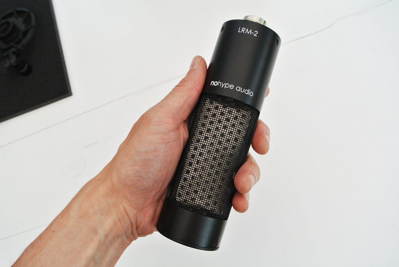

ich hab in den letzten Tagen das Mikro LRM-2 der Firma Nohype Audio getestet und bin überaus angetan. Ich hab mein Review auf englisch geschrieben - aber das Wichtigste werden ohnehin die Audio Dateien sein. Viel Spaß beim reinhören, ich kann das Mikro (145.- mit stock transformer! ) jedem nur ans Herz legen:
Hey everyone, I want to share my opinion on some ribbon mics I currently discovered on the internet and ordered for my studio.
It’s the Nohype Audio LRM-2 ribbon microphone. Not many of you might have heard about this company from Belgium and it was hard for me to find material about the microphones on the web before ordering.I was looking for a matched pair of ribbons for Blumlein stereo recordings (room mics and drum overheads) and I also wanted to use them individually on guitar cabs, vocals, etc.
First things first – I can’t believe the quality offered for such a low price of 145 € per microphone. It’s insane and probably the best deal I did in the last 3 years.
With quality I mean the quality of the product itself, the sound quality, and the customer support. But lets start from the beginning:
I ordered the mics in Belgium on Monday and they arrived two days later in my studio in Berlin / Germany. All the questions that I had asked before were answered within hours by the owner of the company Jean-Pol Gerard. The mics came very well packed in the bigger box I found two individual boxes – one for each mic. The packaging is stripped down to what’s necessary, but even the way it’s packed with all it’s understatement speaks “quality” to me.
There’s no fancy suitcase like so many Chinese manufacturers offer, but all the accessories make perfect sense. The mics come with a soft bag made of some kind of neoprene, and an uncommon shock mount that works perfectly (listen to the files) and that is built of heavy metal. No plastic parts except the elastic cord :) The mic itself is about as big as an MD421 and comes in a beautiful matte black finish. It almost reminded me of unpacking an apple product and I instantly fell in love with the looks and feel. It’s absolutely flawless.
Just to compare the mic with another well regarded low cost mic, I ordered a MXL 144 to test them side by side. When I unpacked this mic, I felt like unpacking a cheap toy in comparison. The mic itself looks good, but the packaging, the plastic box and the shock mount are of very cheap quality. The Nohype exceeds this by several levels IMHO. I had also noticed that the MXL came with a slight ribbon sag, meaning that the tension of the ribbon was not perfect anymore and a bit curved.
As far as I know, the final assembly of the LRM-2 takes place in Belgium, and for me as a buyer. it’s great to know that someone actually checked and built the mic by hand just days before sending. This gives me much more confidence in a product than buying a mass-produced ribbon mic that most likely had a bad quality control.
The design of the LRM-2 is absolutely unique, and it proofs that it’s not one of the ribbon mics that is made in one of the big companies that basically make all the same cheaper ribbon mics for Thomann (T-bone), Musicstore (Fame), Avatone, Justin, Golden Age, etc.

War das Bändchen nicht bei Holger Siedler zu bekommen?
Ein befreundeter Saxophonist zeigt sich nach ausgiebigen Testeinsatz kürzlich sehr ernüchtert. Sehr starke off-Axis Verfärbungen bei bewegtem Spiel, Live also kaum zu gebrauchen.
Gerade für Brass wird das NoHype ja ziemlich angepriesen, weiß daher nicht was ich mit dieser Aussage anfangen soll. Ich besitze es auch, habe es mir nach einigen positiven reviews im Netz damals ebenfalls angeschafft.
Muss aber sagen, ich nutze es recht selten. Die einigen Male beim Konzerteinsatz, hat mich das Ergebnis an Sax, Grand Piano und Trombone aber ebenfalls nicht so sehr vom Hocker gerissen.

Kann es sein, daß sich Dein befreundeter Saxophonist nicht mit Richtcharakteristiken von Mikrofonen auskennt ? Bei bewegtem Spiel käme eine Kugel in Frage, event. sogar noch Niere, aber niemals eine 8. Wie wäre der Test verlaufen, wenn er ein Royer 121 genommen hätte ?
Ich selbst habe das LRM-1 mit Taiwan Trannie, und finde es Hammer. Das LRM-2 soll wegen der verbesserten Gehäusekonstruktion noch besser sein. Lundahl ist immer sehr schön, nur manchmal will man eben diesen knorzigen Sound. Der Lundahl ist halt deutlich linearer. Beides hat seine Daseinsberechtigung. Die Qualität von NoHype geht mehr als in Ordnung, wenn man mal die Konkurrenten vergleicht. Super Service, Holger Siedler macht einen tollen Job, und der Kontakt ist sehr freundlich.

Bei den NoHype Mics gibts genügend Höhenauflösung schon mit dem Taiwan Trannie. Ich hab den Pronomic Mod auch schon gemacht, da finde ich es schon eine deutliche Bereicherung. Bei den NoHype kommt es auch auf den Geschmack an. Ein gewissen Grid, Knorzigkeit, im besten Falle Vintage bekommst Du mit dem Taiwan Trannie. Der Lundahl klingt halt linearer, eleganter, mehr hifi. Wenn Du Bändchen suchst, würd ich mir ein Pärchen mit Lundahls gönnen, oder aber ohne. Ganz nach Geschmack.

Übrigens wurde mir v. Holger gerade für Brass nicht der Lundahl Übertrager empfohlen, da hier eher der kernigere Sound des Standard Übertragers seine Stärken ausspielt. Lundahl ist genial für leise, eher "schwebende" Klänge...also hervorragend für klassische Aufnahmen.
