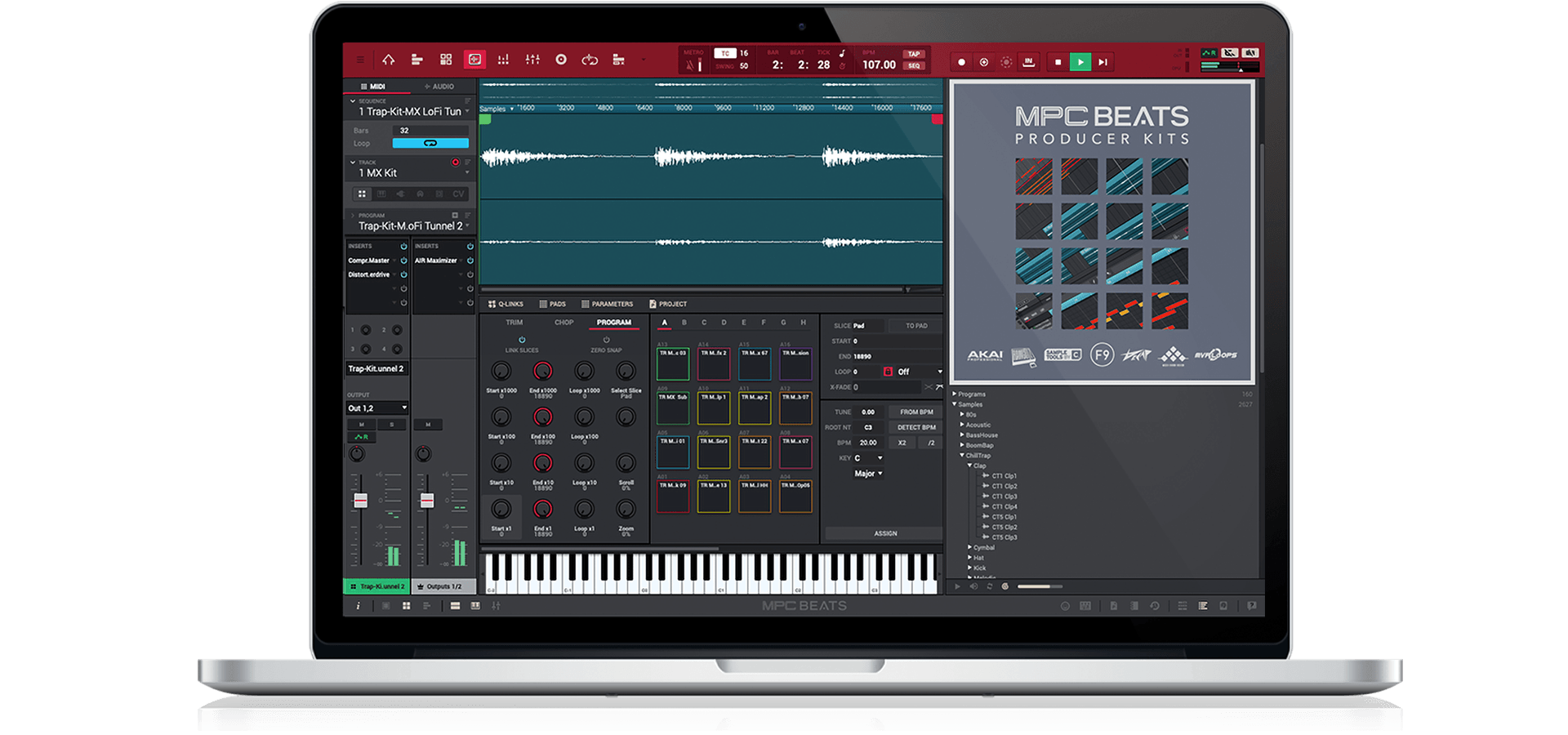

  • 6 PADS FOR TRIGGERING DRUM SAMPLESAND LOOPS
  • PIANO ROLL TO RECORD MIDI NOTES
  • SAMPLE EDITOR TO CHOP & EDIT
  • BROWSER TO SEARCH & SELECT SOUNDS
  • INFORMATION SECTION TO SELECT AND NAVIGATE BETWEEN TRACKS
